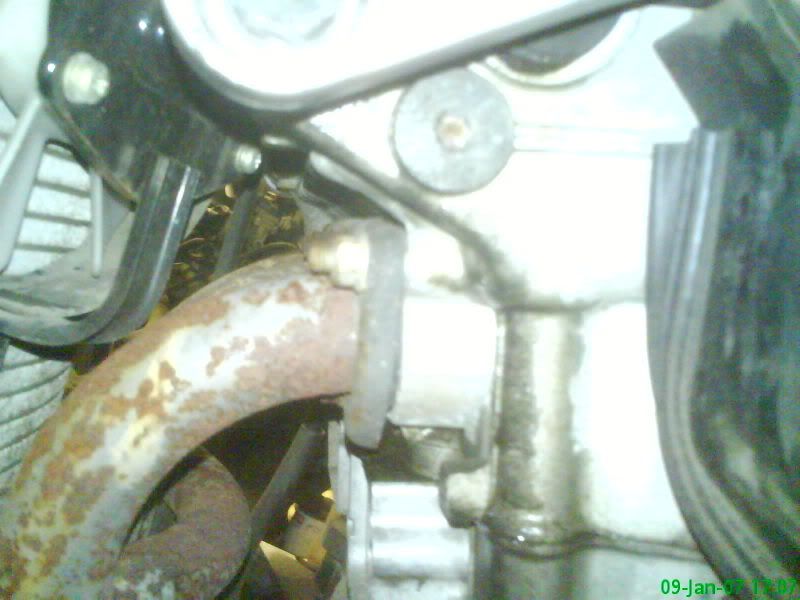

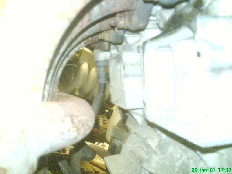

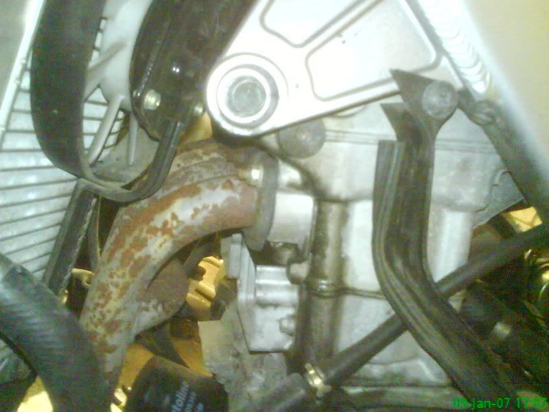

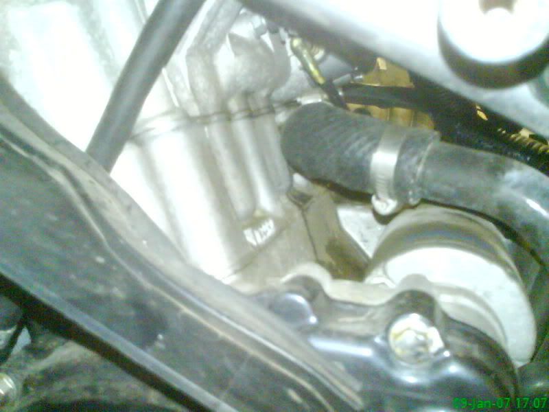

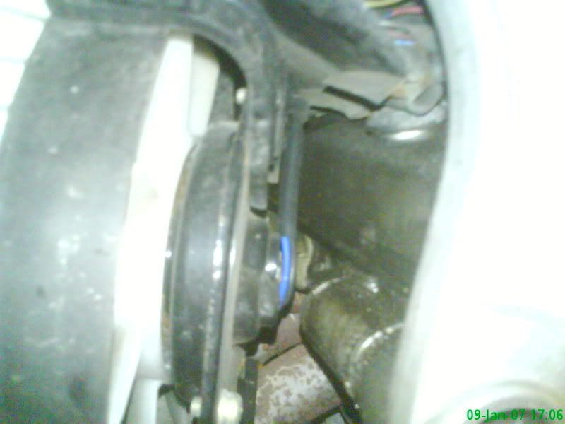

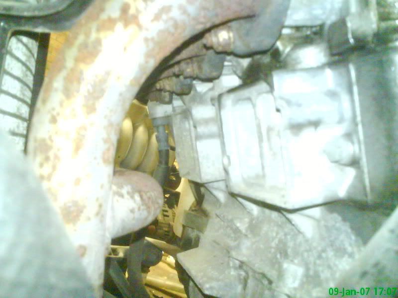

Had a few problems with the beast dumping coolant. So finally have got round to checking her out.
First things to check Thermostat and rad cap, had both of them out and put them in a bowl of boiling water, both opened up. So that leads to the dreaded head gasket failure.
Gonna change it at the weekend, but not something that I have ever done before, so any advice on do's and don't's would be appreciate, I have a good idea of what I have to do, but there are somethings that I am not going to know.
I assume if I have to have the carbs of will have to balance them out after.
Here are a few pics of the head.
You can notice some leakage around the head, so it looks like it is likely.
Oh and ignore the rusty downpipes.

Is the leakage not coming from higher up at the rocker. It looks like its just oil seeping out not water. I,m sure someone will advise on the procedure but I,d be inclined to check the waterpump first if its poss (dont know much about these I,m afraid).
Is the system pressurising when the bike is running, have you noticed any bubbles coming up to the rad cap, if so then that could be a sign of head gasket failure.

Just where exactly is this coolant being dumped from ?
There are little drain holes form where the spark plugs go that drain oil/water it can look like a head gasket is gone when it's only one of the rubber seals on the cam cover.
The little holes exit just under the exhaust ports.
Replacing the head gasket is straightforward (and you won't need to balance the carbs).
Truth be told it's easier to drop the engine out to do a head gasket.
