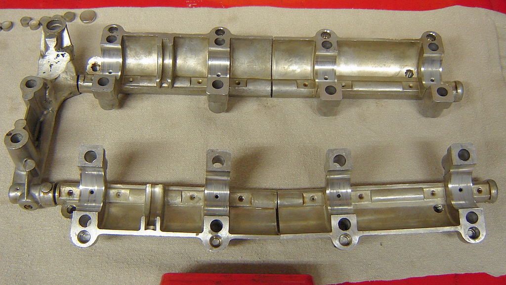

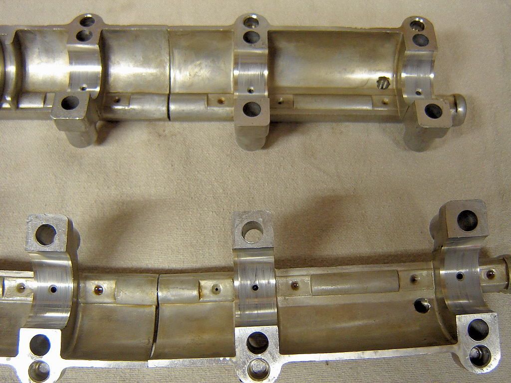

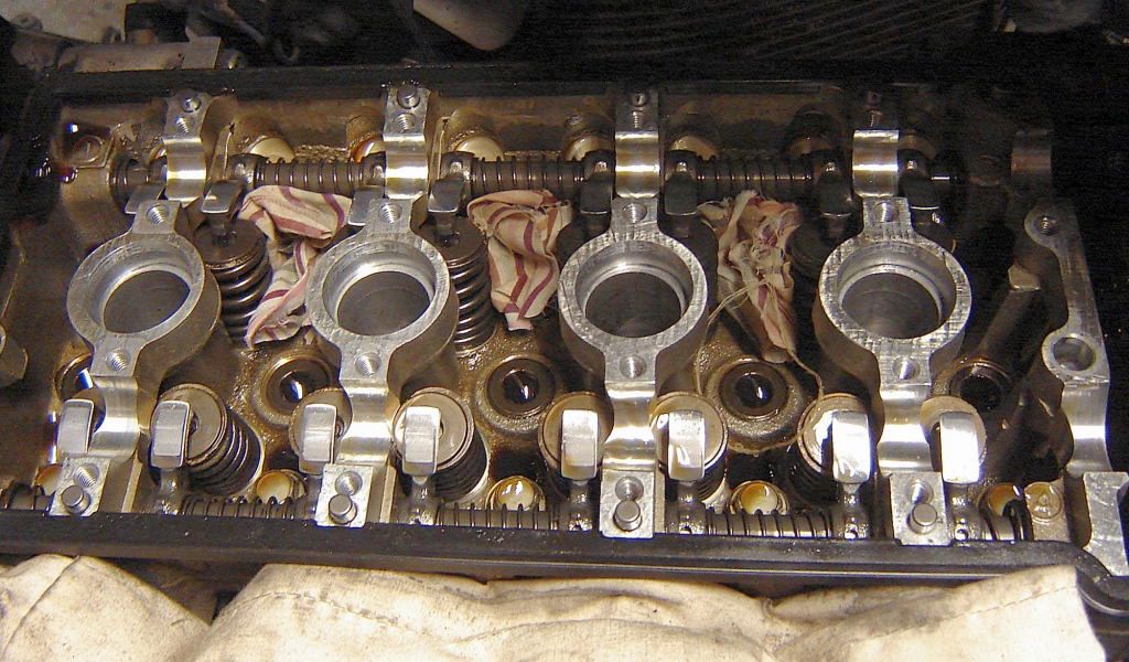

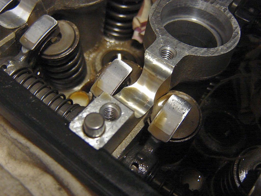

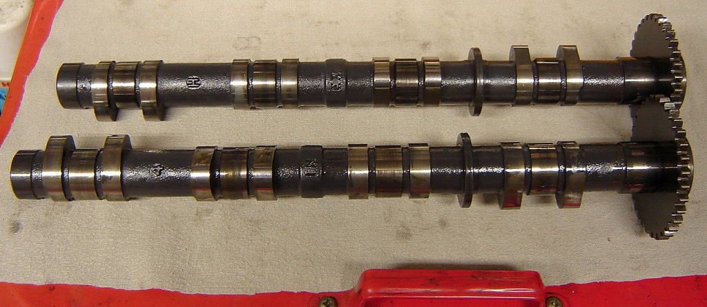

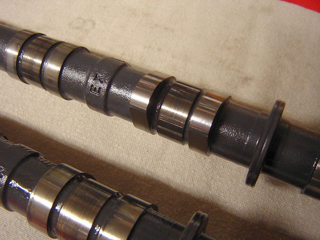

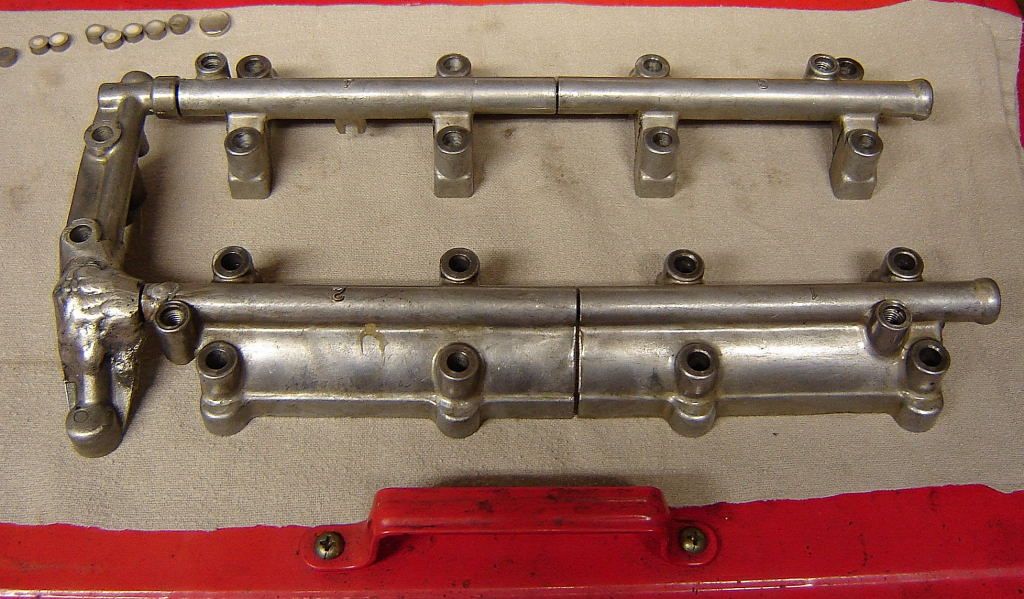

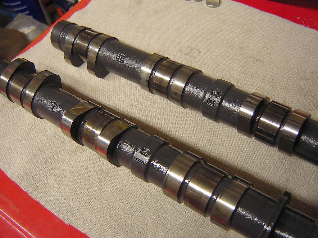

Pictures of the cam parts....... Nothing was missing as far as I can tell. I have taken all shims out.
'New' rocker arms look ok. Move up and down nicely.....I must check the point where they touch the shim though....
What the hell is all that welding!. That alarmed me when I saw it. However it appears to be ok. Not a load bearing part or bearing surface. I need to check the oil feedway has not been blocked inside.
Why didn't they just buy a replacement part when they broke it??
Bearing surfaces in the camshaft caps appear a little worn, but not excessive.
That big shim is not a shim, it is a battery from my vernier calipers! ha. It will not be going in the engine.
The oil feedway seemed to have oil in it on each bearing surface, suggesting it has been getting oil.
Camshafts look fine.
I would say hardly any wear at all.
Any thoughts?
Hope I haven't overdone it with the pictures.......
Any thoughts?
- Posts: 3342
Re: Need shims bigger than 3.50.
you could try measuring the valve clearance in the right place

- Posts: 2320
- Location: Herefordshire
one version of the manual says between rocker and shim, other version says between rocker and cam ..
so really .. both are right ..
hasnt got reground cams (kent) in has it ?
they take a bit off the base circle during the regrind necessitating larger than normal shims

- Posts: 2320
measure the lobes etc .. standard specs are in the H model manual iirc
its possible they were acquired cheap and just thrown in without setting clearances ?
- Posts: 2320
looking at the pics though ... the cam journals are slotted.. stock cams arent .. its an "F3" mod,
check out pages 7 and 8 of the zxr400r (racing) manual (http://www.zxrworld.co.uk/Manuals/zxr400r.pdf) and you'll see what i mean
recommended valve clearances in the same manual are 0.25 inlet and 0.28 exhaust, its increased to allow for the extra thermal expansion likely in a race engine .. does make 'em clattery as fsck when cold though.
so, possible they are re-ground and possible they were just set up on the loose side... probs when that cam cap snapped and was welded up.. maybe the oil starvation ate the original cams ?
(they're easy to break btw, if you dont ensure 100% that its sat down nice on the dowel when tightening its just *crack* -- bugger ..)
