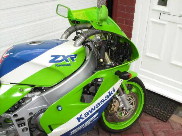

Ok here's the green machine, but need to seek some advice please as to whether this is a genuine SP, J model? I thought it was the H1 model stickered up but having read of some of the topics, it has the green shock and single seat configuration (which does not fit flush to the frame), so have I struck lucky or any other tell tale signs I can look for? Hope the pic helps. Still a bit of a virgin with all this (although it was a mid life crisis purchase, or so the mrs says!).

Hard to tell if it's a SP from that picture.....................
big differences are
SP has compression adjustment on forks at the bottom
SP has flatside carbs
SP has close ratio gearbox
SP has a different ignition box
SP has single seat
SP has bum pad removable to allow access to seat hump space
SP has different sub frame
SP does NOT have pillion pegs
if your unsure post some picures

It does have the remote damping adjuster on the rear, damping adjuster screw on the front forks, sp seat unit, is that agreen spring i see on the shock? (SP shock at least, if it is). On the face of it it looks like an SP.
As cargo has mentioned theres more to it, 16tooth front sprocket is a giveaway too.
Re: Kermit saying hello, SP or not?
I think it's worth noting that nearly all the parts that make up the "extras" on a SP model will fit any other model and so just beacuse a bike has SP forks that doesnt make it a SP.
with so much interchangability of parts it would be very easy to totally convert a L or H model to SP..........even the gear box is a straight swap.
I once saw a ZXR advertised as SP model...................the only thing that the seller had to prove that it was a SP ws a home made sticker on the side that said "SP"
I've said it before..................buyer beware
So lets see those pics.................carbs, ignition box, fork bottoms will do for starters.........then we'd need to see inside shots of gearbox and camshafts

Here's another couple of pics taken just as a general overview of the bike. The green screen was something I fancied adding but still got the clear one, noisy can aleady on bike and the no 9 is my little homeage to The Stalker.

lovely example Paul! welcome to zxrworld.Whereabouts in WM are you?

The SP was a model produced by Kawasaki with the intention of using it as a race bike for a 400cc racing class in Japan all the little extras are aimed at making tuning and modifying it for racing...............I dont think that it makes that much more power over a regular H
As a road bike it could be considered that a H or L model is actually better than a SP
The real value in a SP is that certain parts are rare and much sought after particulary by those of us who race ZXR 400s
A SP gearbox will fetch £300 or more if you are lucky same for the flatside carbs and SP camshafts. There is £900 for just 3 parts you could buy a whole H model for that.
The single seat unit/subframe is sought after by road bike guys keen to have a bike that looks like a SP
The forks can fetch good money too from racers for the adjustability...............( I dont rate the SP forks I've got a set and my ordinary forks work just as well)
IMHO demand for the SP goodies is waining slightly as 400 racing is in slow decline now that 650 twins are on the rise
If you just lift your seat and get a picture of the ignition box that would be a big give away as to what you have

Its a 1990 H2 SP (J2)* .. only thing to be confirmed is wether the original engine/ignition/carbs are still fitted.
very nice bike, lucky you, am V jealous.
*H model SP's are "J" models, L model SP's are "M" models

If what youve found out that its a J model is true, then yes its an SP as Zimm said. But as parts are interchangable then it could be that certain parts have been sold. But like i said, 'on the face of it' it looks like an SP. Get that ignition box pictured and we can see for sure if its an SP :)

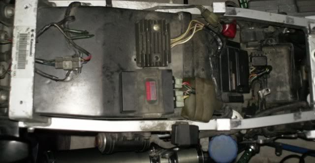

AMENDMENT: I did take a couple of pics earlier today what I though was the ignition box area, but wasn't..doh (thanx Zimm). Will post another couple up in a bit.

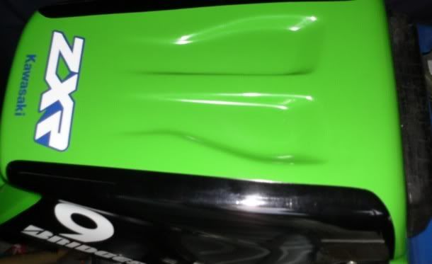

And a view of the tail unit, the rear seatpad has crackled, do you reckon that could be restored?

the ignition box is under the pillion seat (hump) on an H.. the shock isn't an SP.. if it is it's off a J1 (they didnt have all the bells and whistles the later ones did)

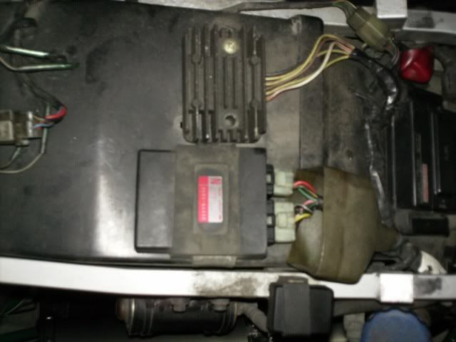

Ok lets try again re the ignition box....for those who hadn't seen the earlier pics, I'd taken a pic of the battery area/fuse box..hope I didn't make a muppet of myself!!

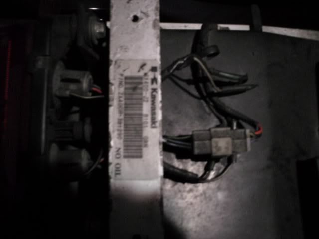

Took the seat unit off and removed a brace type thing that holds the plastics on. On what I think is the ignition box there are codes: 21119-1292, 131800-5390. 12V TNCF12N (Denso Japan)
The sticker on the subframe shows it as a J2, and the frame id 301290.
