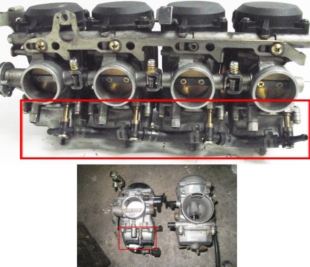

anyone have idea what is this on carb? ZXR400
baak
Post by baak »
picture is 91model I think but I have no such a thing like that on my carb L7
what is that for tube thing?

Idle mixture screw or carb heaters, depending which part you meant

Hi, i mean that Gold and black colored tube things in red box. what is that? which is not exist on my carb.
mine has just groove like. (ZXR400 L7)
-----------------------------------------coment add---------------------------------------
oh~~! now I know, thanks. but that's no necessary anymore these days?

baak wrote:
bendog66 wrote:Idle mixture screw or carb heaters, depending which part you meant
the gold tubes and black rubbers are your carb heaters, they are designed to divert some hot coolant to the back of your float bowls to increase the temperature of the fuel by a few degrees to prevent the possibility of carb icing occurring when its cold, humid and you are on full throttle.
only seen on bikes where it is a possible occurance, most people remove them, ive never known of one credible occurance of carb icing on these bikes, i thought i had it, but it turned out to be poor mixture control.
