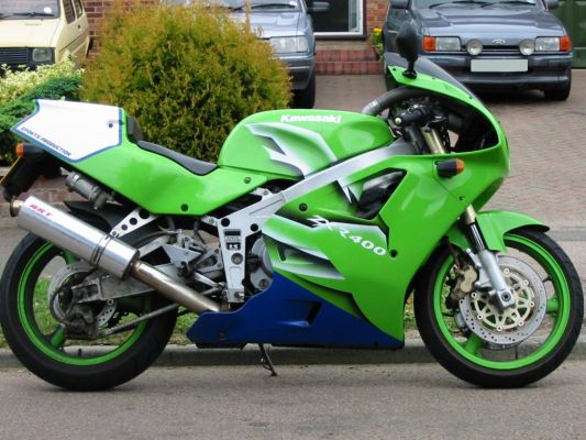

main difference between H and L is the frame................................
This is a H
and this is a L
There are of course more models and other differences like H model SP or L model SP
But the above pictures given you the basic difference between H and l
