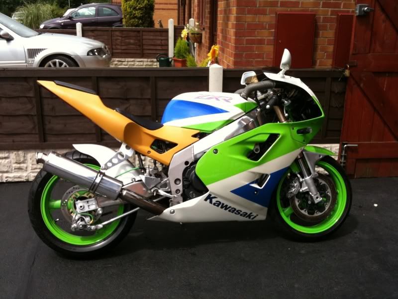

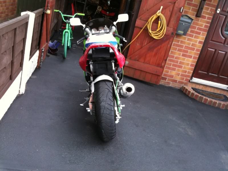

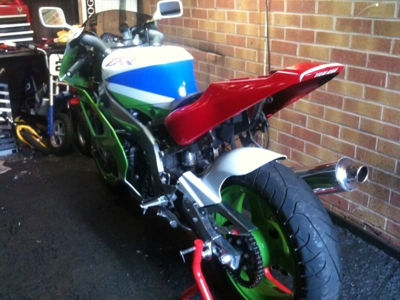

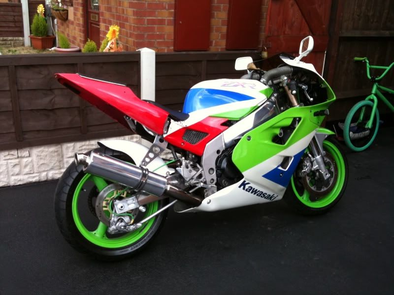

Here she is a few months in , polished the fram and swinging arm and a few other bits

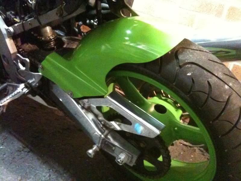

painted the hugger white

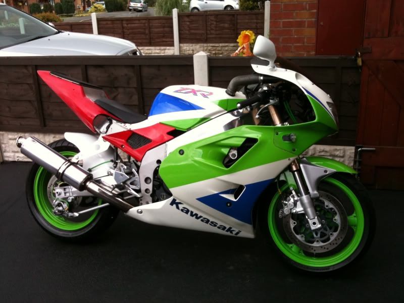

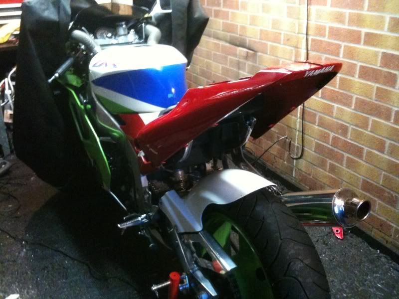

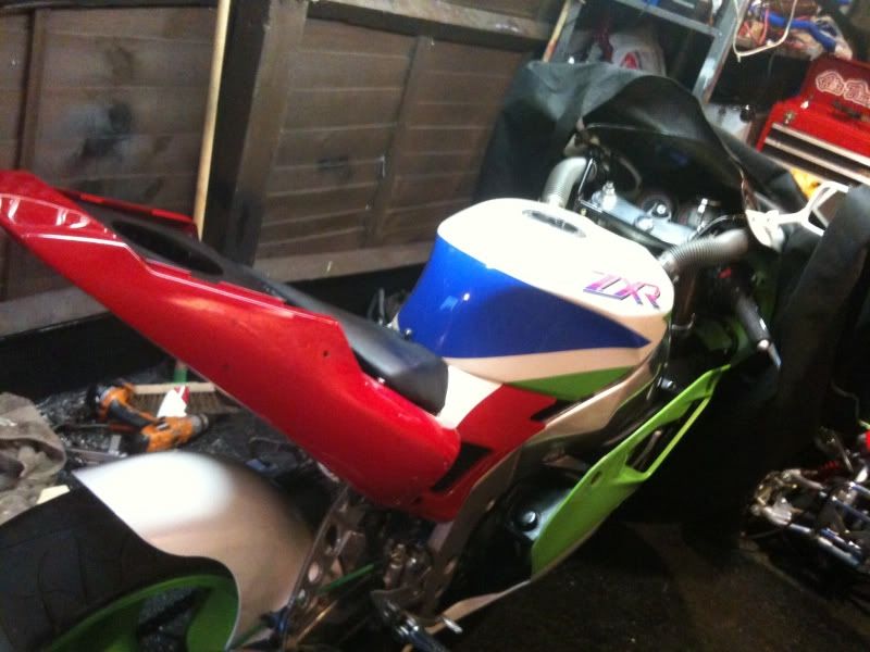

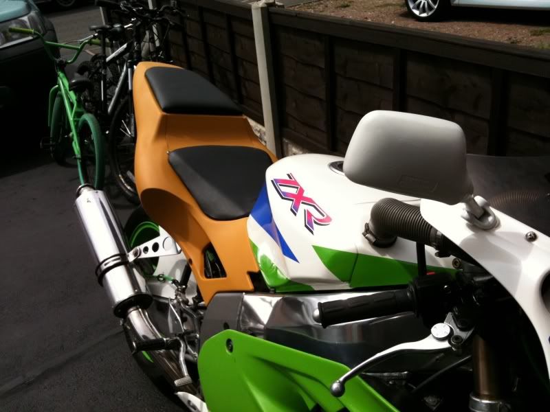

then the fun begins, after doing a search for a nice rear end , i started making my own ,this has involed cutting of the zxr side panel and matching to an R6 rear end, and under tray.
back in place but no zxr panel

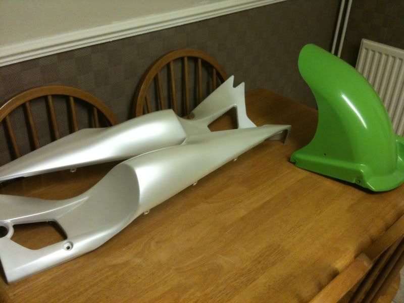

zxr panels cut ready to join
few brackets made to join the pair then some mesh , ready for fibre glass , the rear frame has been totally moded and ill do some photos of that later,

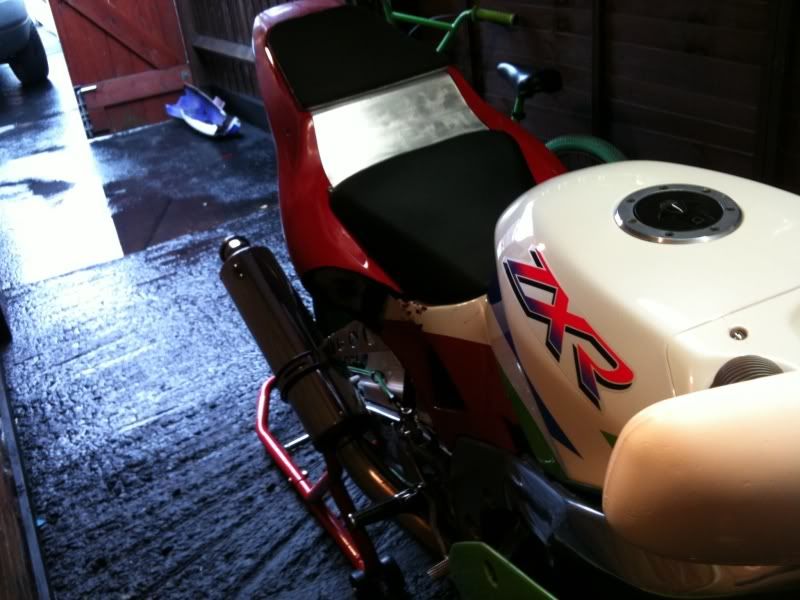

filler section betwween seats
quite a few hours work and ive used the original front seat but made a rear pad to fit the back end, all in filler primer now.

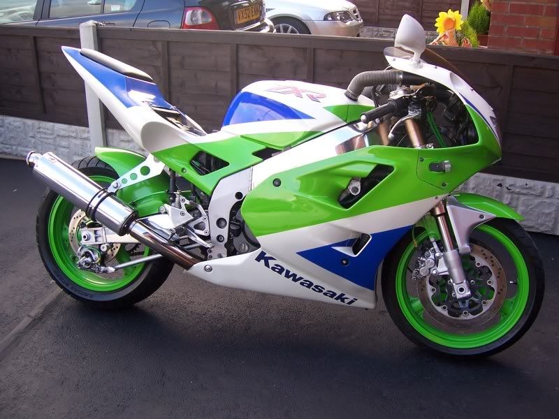

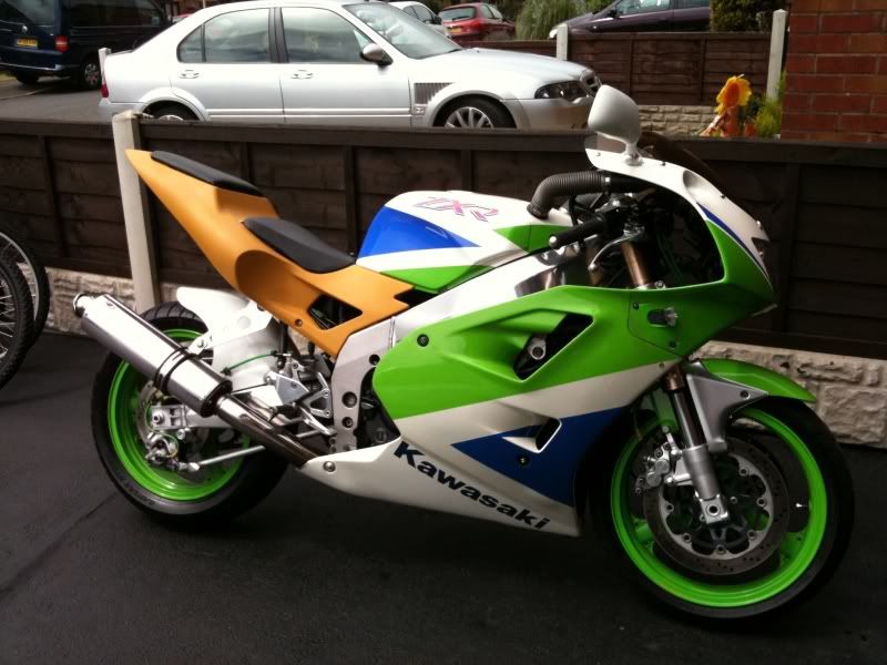

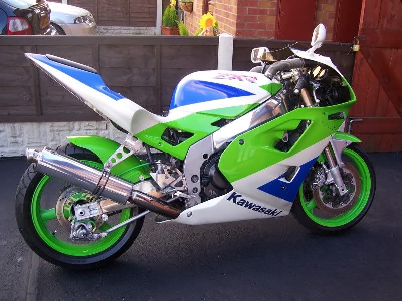

finally looking like a bike again

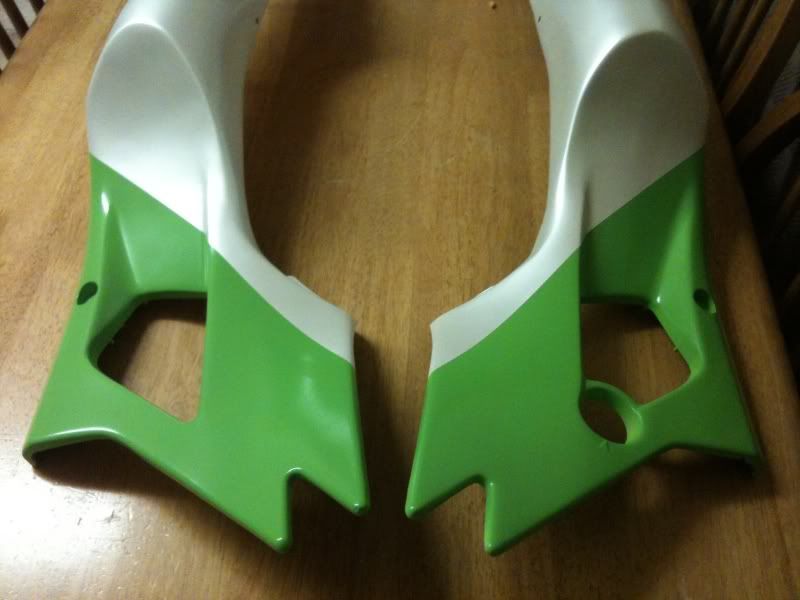

first coats of paint last night , green and pearl , no clear on it yet ,
hugger is now green , as the undertray will be pearl and it would look to much white at the rear
so thats where im at , just waiting for the guy to deliver the undertray and lights so i can paint and fit that , tonight i will paint the blue the clear, flat and polish the week end, ill do my best to keep posting as and when , hope you like it
