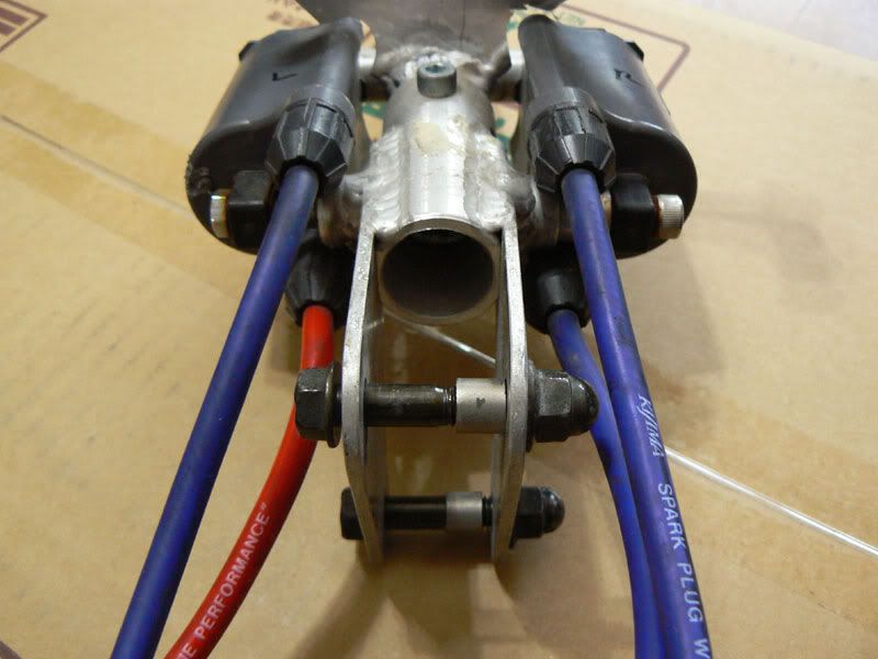

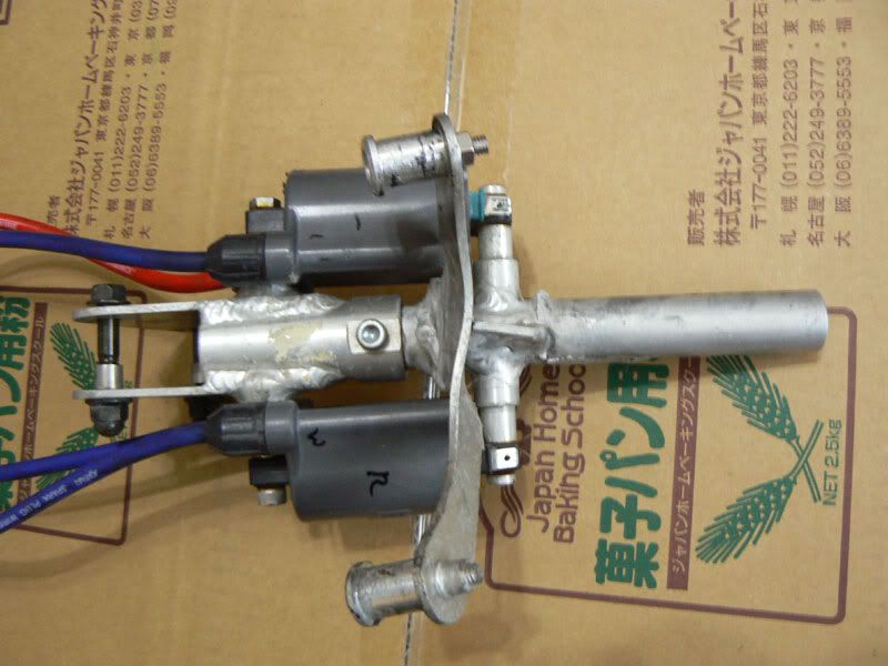

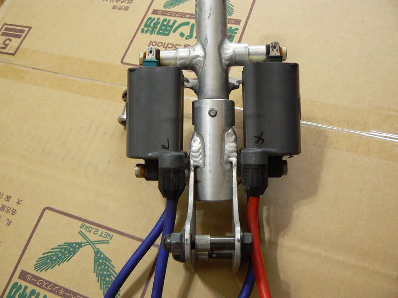

Just to give an idea of how to mount up the coils out of the way of the RamBox if your going to be using one.
This has been in a tumble so the mount for what i assume would be a dash of some sort is a bit twisted. Haven't been out to the bike with it but guess it bolts onto the headstock.

Drew- found this in a box of bits - looks like this goes at the side of the engine (LHS) supported on the upper fairing support with HT leads going under the frame beam. I havent seen this arrangment before but it looks a bit neater than where I was originally planning.
Dave
