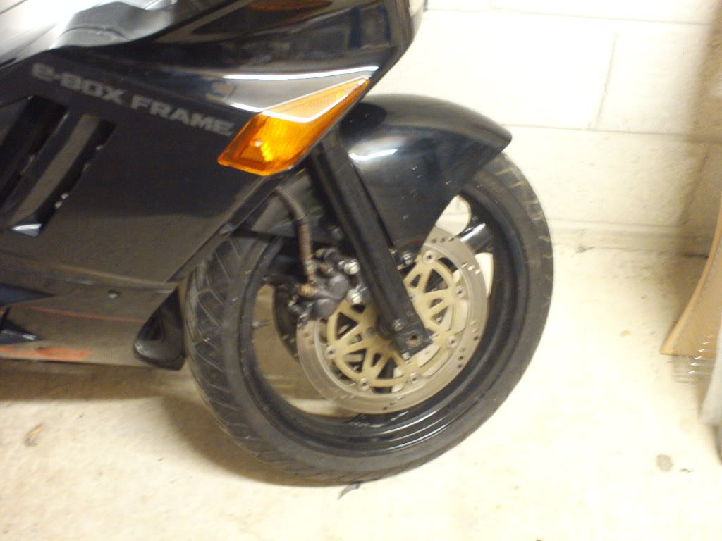

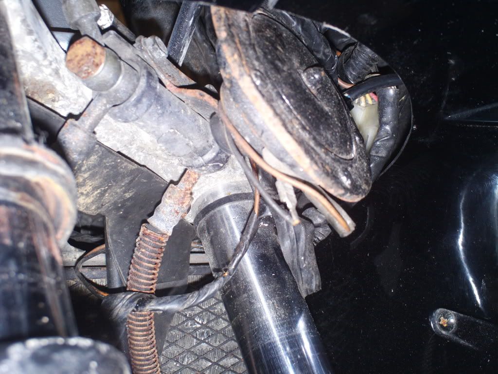

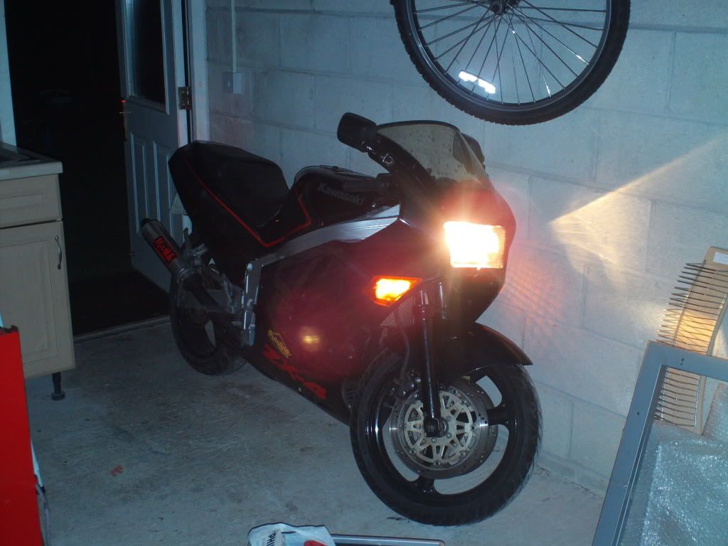

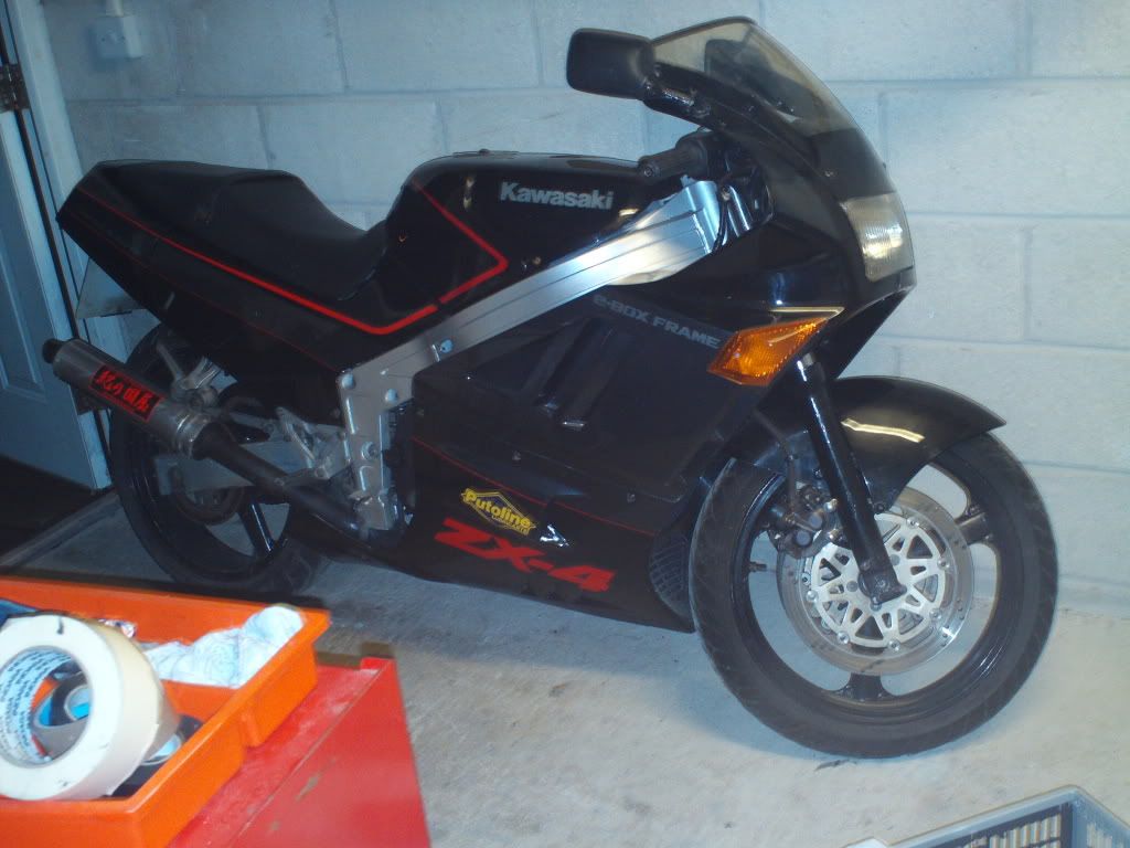

Well here is the bike rebuilt on frame with good log book, needs a tidy round in places cosmetically , i notice a lotof people are going with the black frame powder coated these days looks nice am tempted but since my bike is black it may be to much >?
Clocks in kmh got a cheap converter although im sure its not accurate lol
The indicators come on with the hedlamp ?
and the rear view street hawk lol
she does needsome attention still
anyhow shes still a work in progress .. ! :gamer

Looking good :smt004
Keep an eye open for cheap GPz600R clocks on fleabay that will get you MPH - also look for smashed sets and just swap out the internals.
GPz 550 clock internals should also fit along with 750's.
Be better looking than that overlay :smt002
Keep the good work up,
MM! :smt001
PS. Indy's are cruise lights and that's common on Jap spec' bikes so it's a grey import.
