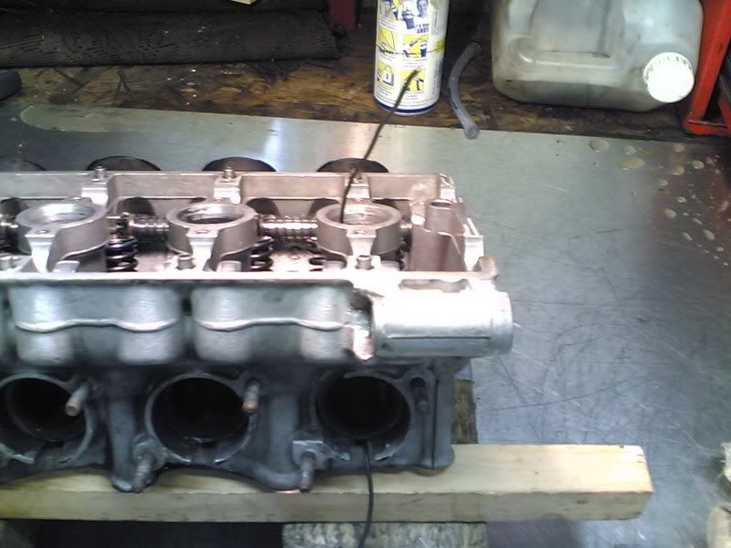

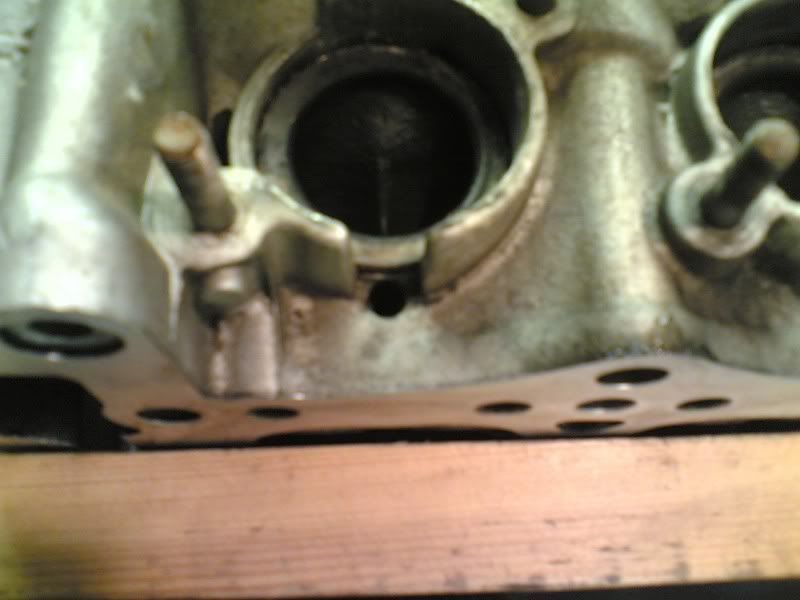

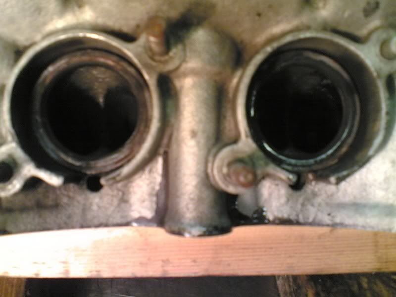

I took these shot today to help others find these pesky little holes.
Also in one picture you can see where I've put a bit of wire up through the hole and out via the spark plug recess.
I do hope these help

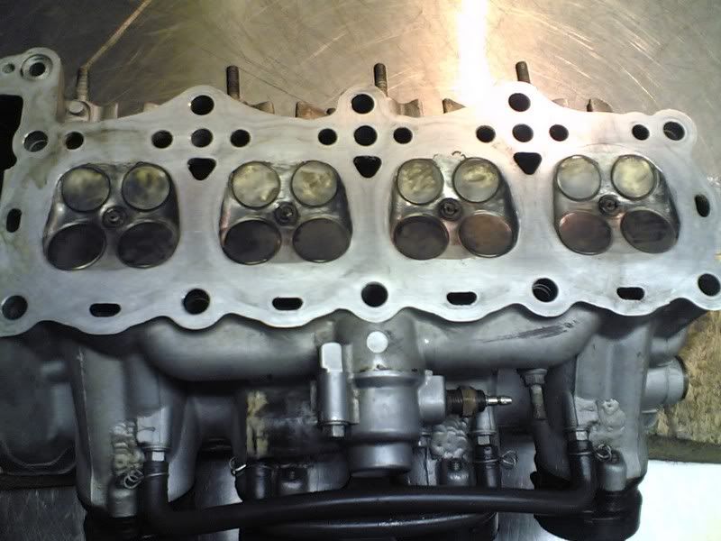

I took this head off this afternoon and was happy to find some flat top stainless steel valves in there :smt003
