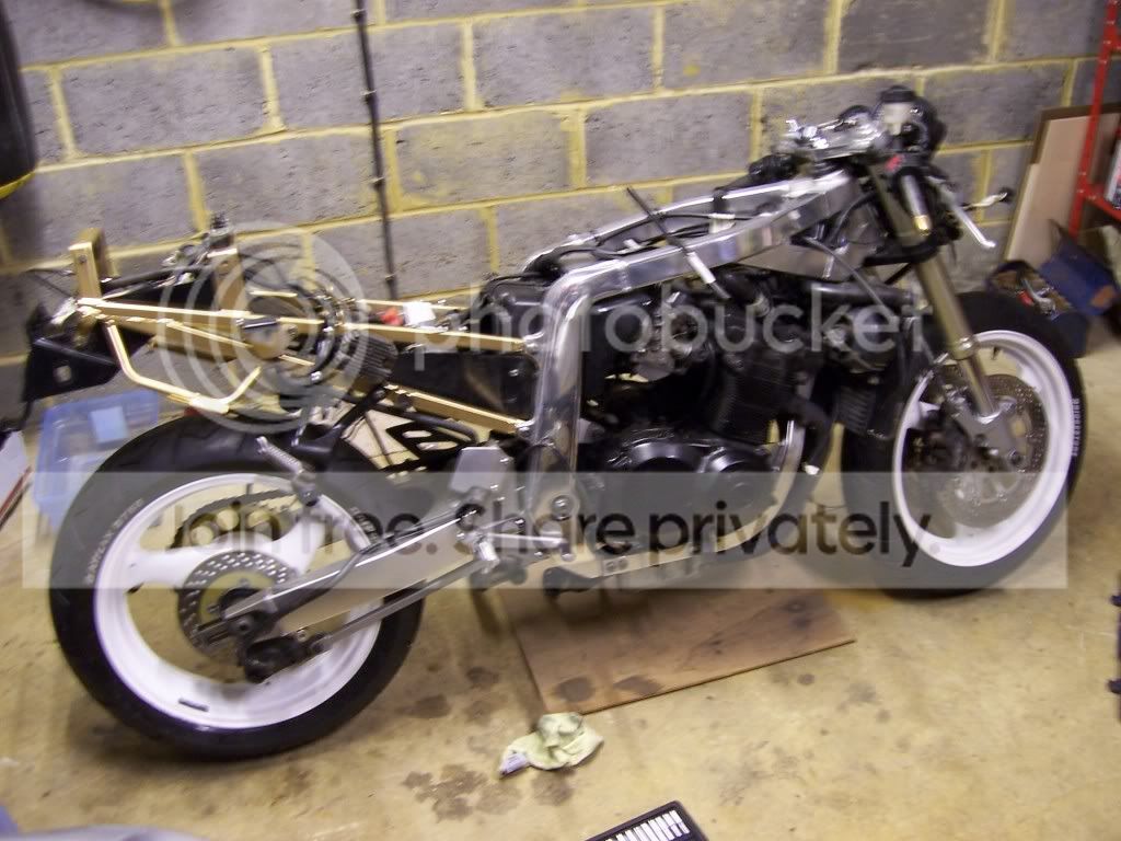

Sooo back from uni now so screw revision for exams in april im gna do the bike :smt003
Have got quite a lot done in the last day! Will post photos tomorrow as its dark in the garage at this time.
Rims painted white, getting tyres on tomorrow
Left and Right engine casings were scratched so now painted in high temp black paint
Entire wiring loom back in, new battery hooked up, couldnt work out why nothing was working......DUH!.....Got to turn the key obviously! Lights on an working, dash lights on, and wheni press the starter it turns over :excited at least i know ive wired it all up correctly!
Tomorrow the wheels are going on, new set of carbs going on and cooling system radiator etc, then were gonna see if we can get it to run!
Photos tomorrow :smt002
arkell
Posts: 333
Joined: Sat May 31, 2008 1:46 pm
Re: Project GSXR400, on here cos 400GreyBike is rubbish
Post by arkell »
sooo rubber on rims and balanced today. That rear wheel on the gsxr is an absolute bitch to get back on! Took me about an hour of swearing before i managed with the help of my old man :smt001
but it's on now and looks good i think. Pads removed and cleaned and then whacked the brakes back on too.
Starting to come together now, just need to rig the carbs up correctly which is what i'll be doing tomorrow :smt017
Got a 'yoshimura' exhaust heat proof sticker to go on my carbon can too (despite the fact its not a yoshimura can shhhhh! :smt003)

no, it wont run above about 2k atm, carbs are spotlessly clean and have had all o-rings replaced, float valves right height, pretty sure theres no fuelling issues, AAAAAAAAHHHHHHHHH this is doin my head in what have i missed!??

no no real difference, im gna have a crack at it again tomorrow, try them a bit lower
the rubber manifold conecting carbs to engine looks pretty well worn so that could be the preoblem, letting in excess air maybe?
