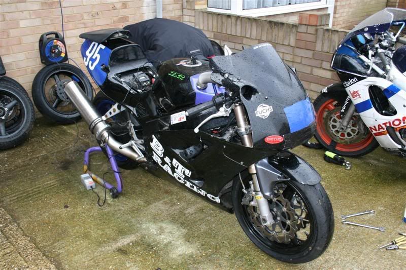

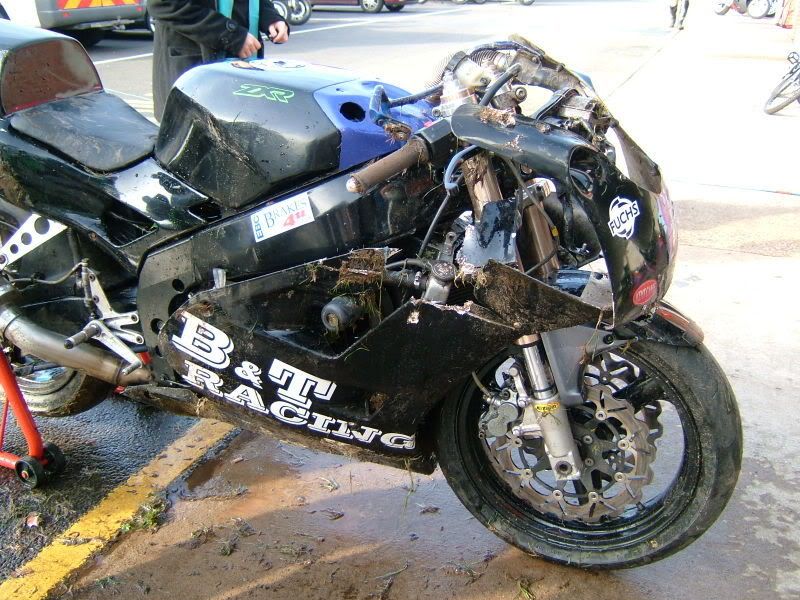

Aforementioned friend then proceeded to get a couple of things that the bike really needed like wavey disks, KTech forks, New Dunlop Qualifiers etc. Things were going ok and some of the niggles were being worked out until he went on a trackday at Oulton Park earlier in the year and turned this...
into this.....
The above picture doesnt really show the whole effect of half of Oultons infield mud and water absolutely covering the bike (pic was taken after the bike was washed down!!!). The incident occured at Island bend where he changed line to avoid another rider and ran out of room so sat the bike up and ran across the infield grass........until.....(baring in mind that this was late Feb)....the nice green grass turned into a large grass covered puddle......in short, the bike got caught up in the deep standing water and threw the rider over the top.
My mate was knocked out and laying in a puddle about two feet deep but the emergency staff were on the scene really quickly(they did a really good job) and the only major injuries sustained were damaged ligaments and cartlidge in his knees.
This was a major blow to him (over 4 months to recover) so he decided to give the racing plans the heave-ho. This left him with a bike that needed a good tidy up (and a bloody good jet wash too) and various other faults ironed out before it was sellable, but alas he needed to get some money quickly, so I stepped in and bought the bike from him.

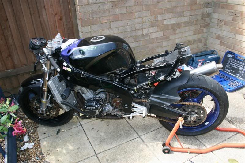

So...the bike is mine, but I needed to know exactly whats wrong with it, so I removed all the broken fairings and threw them in the bin, and then stripped the bike down a litte further and gave it all a good clean (whod have thought that mud could get where in all the places I found it)

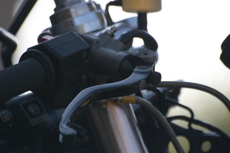

Gave it a good going over and got it running. Also found out that the brand new (for the trackday) Brembo master cylinder took a bit of a beating too and needed the service kit to replace the broken retaining washer.
One of the main issues with the bike is the clutch....it both drags and slips !!
Anyway, new steel plates, and new EBC heavy duty friction plates coupled with an oil and filter change seems to have put paid to them (although I cant really check the slipping part as its not road legal).

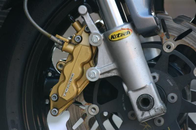

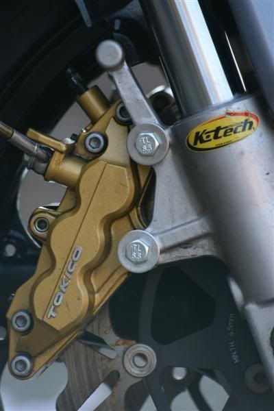

Another of the bikes weak areas are the brakes...so special attention was paid here, quite simply what are the biggest best brakes that I can fit (within a reasonable budget), so after asking around on this forum and getting advice from racers, the GSXR1000 K1-K2 6pot caliper conversion was the way to go.
Following the guide from Rene regards the procedure, today saw the addition of the previously mentioned calipers. A couple of weeks ago I asked a friend of a friends friend to make me up the required spacers to be able to fit these, but, due to various constraints, it doesnt look like theyll be ready before my deadline (Anglesey trackday 14th Sept). So I had a good hard think and have made my own spacers. Got hold of some High Tensile bolts and went about fitting calipers.
Spacers fit like a glove and the calipers are now fitted and bled. Im quite looking foward to seeing just how good 6 pots, braided lines, and a Brembo master cylinder are going to be on a 400.

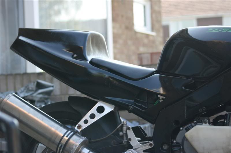

I managed to get hold of a set of race plastics from a racer friend and have now fitted the rear unit

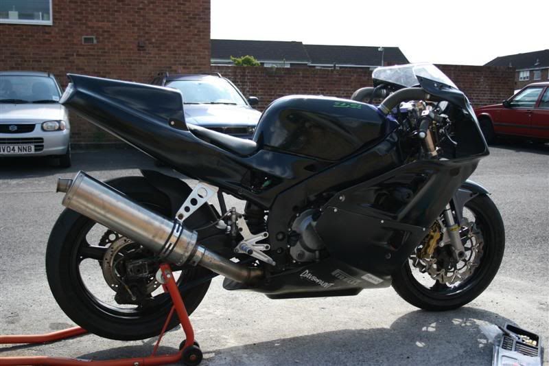

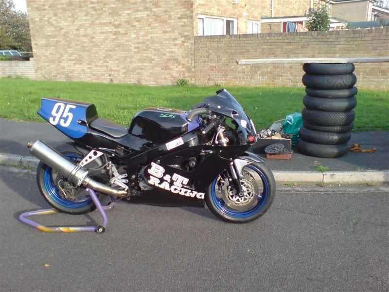

Bodywork was fitted yesterday, so all that is left is some general tinkering to get things how I want
I also fitted the side stand back on, as it can be a pain in the butt if you want to get off the bike but dont have a paddock stand or someone free to help nearby

Re: Project make it work again....properly this time
looks nice man.
watch out for the exhaust link pipe ( looks like a micron?) especially at the banked hairpin at anglesey :smt002
my bro has the same exhaust set up as yrs, and slid the back end on the link pipe coming out of the hairpin, not good when you need to get the power down.
mine was similar, but i bent the pipe right in tight, and cut an 1nch and half off the can hanger, and used the next hole up on the hanger if ya get me? anyways it sorted the clearance prob right out.
