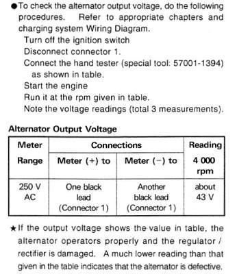

The bike had managed to blow the headlight bulbs, tail light bulbs, rev counter and the rev counter bulbs, neutral indicator bulb, fuel pump relay, starter switch, fuel pump and battery.
In trying to fix the bike I have replaced all the bulbs, fixed the starter switch, new fuel pump relay, new regulator/rectifier, new fuel pump, new battery and new coils.
With all of these bits having been replaced the bike was running the battery flat and stalling so I have tried a second reg/rec.
<><><> Having left the flat battery on charge for a while the bike started and ran as normal. The battery seemed to be charging and showed around 13.5v when at I assume (no rev counter) about 4 - 5K revs.
I left the bike to reach temperature until the fan kicked in and the bike stalled. I tried again and could stall the bike by giving it a few quick consecutive pulls on the throttle. It also stalled if I switched on high beam. I put the multimeter back on the battery and was only showing around 12.5v when rev'd to around 4-5k revs.
I put the battery back on charge, let the bike cool down and tried again. The process repeats as from <><><> above.
What is wrong with the thing? Any ideas?
