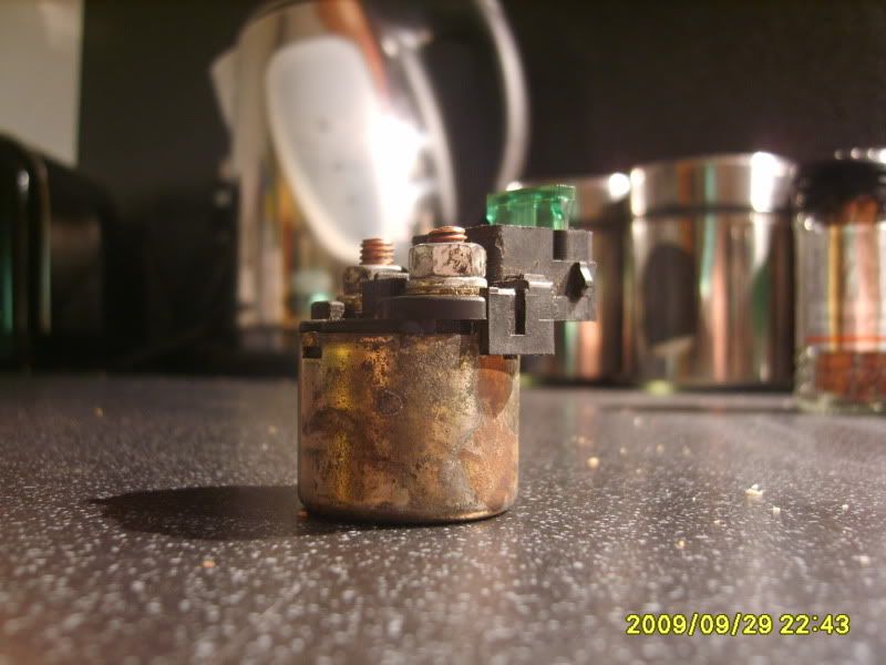

Well, I've been out side and had a play. Thanks to all for the suggestions, it turns out it's this
It's the starter relay or solenoid. One terminal goes to the battery, the other to the starter. I bypassed it and after a few sparks and a melted bit of wire I used, it started fine. So I'll go order one and fit it in time for my test next friday.

ye thats starter relay, hopefully that fixes it
