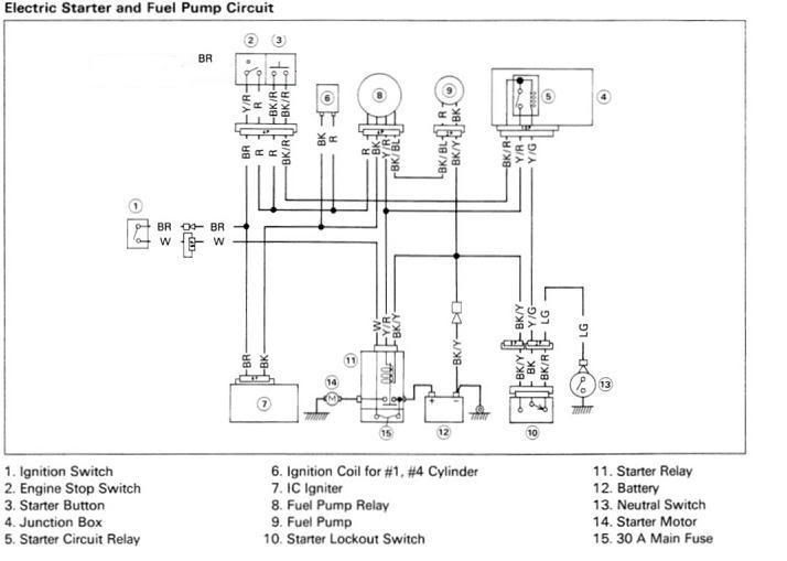

Here's the circuit I posted in another thread;
The relay within the junction box determines whether the starter motor spins and the fuel pump gives a little juice as far as I can tell. So if it is spinning and sucking some petrol you could elimainate that?
