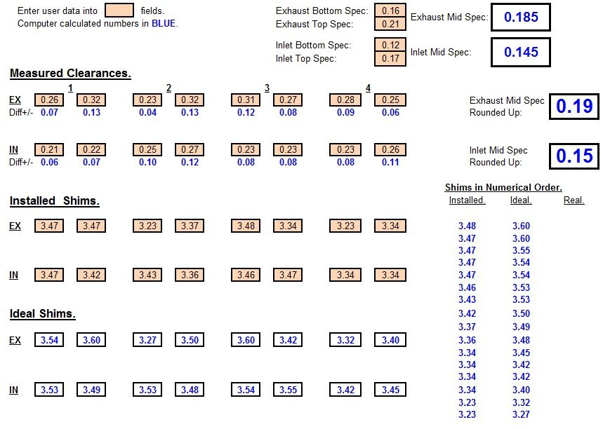

Well, for now, I am having a go at just moving around the existing shims to give a broad 'loose' spread of clearances.
This will have the effect of closing up the biggest of the clearances and also making a tight exhaust clearance loose now, which is important.
However all clearances will be out of spec, but they were before anyway, and it sounded fine, so we will see how it runs.
Below is a screenshot of a Microsoft Excel spreadsheet I use to help organize the numbers - so you can see whats what.
This just shows the clearances now and the shims fitted now, not as it was originally.
