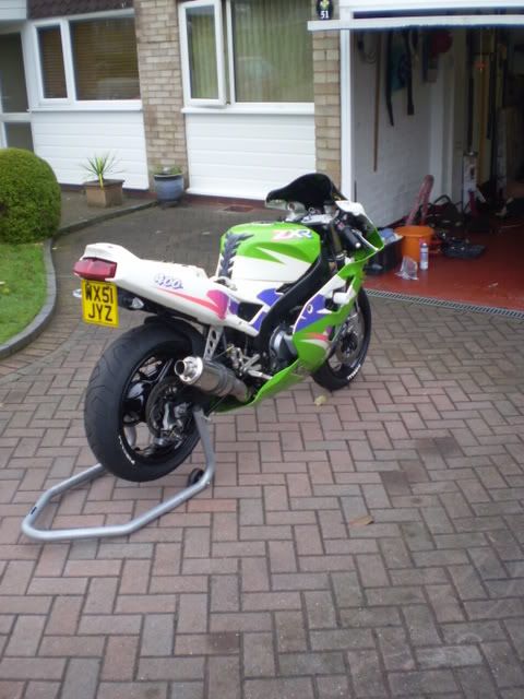

Re: I'm Down.
Here's how the bike looks at the moment
. Stille got a few things to bolt back on and the fairings were a Camel to get on. I think some of the mounts were damaged but they're on now. Note: Some aren't done up porperly yet hence the gap at the front. So just gonna check and re-check everything now and then take it out for a test. What do we think to the front wheel and the gap?
Re: I'm Down.
looking gorgeous mate, gonna be uncomfortable with no seats tho'
