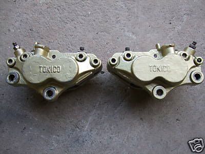

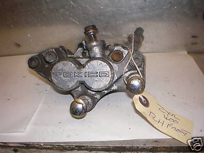

is there any difference between these calipers?
i got some of the top 1s with a load of spares and didnt no if they would be any better than the bottom 1s? cheers doug

the top ones look like 750 calipers to me.

Or H calipers. Check the piston diametre's, they should be bigger than the L's and will therefore give a better braking force

The top ones look like Colins (fatspanner#44) on here. He has a couple on e-bay at the minute I think. If so they will fit a zxr400l (or should do as thats what he races)

top are zxr h calipers bottom are L .
tell by the size of the tokio logo
